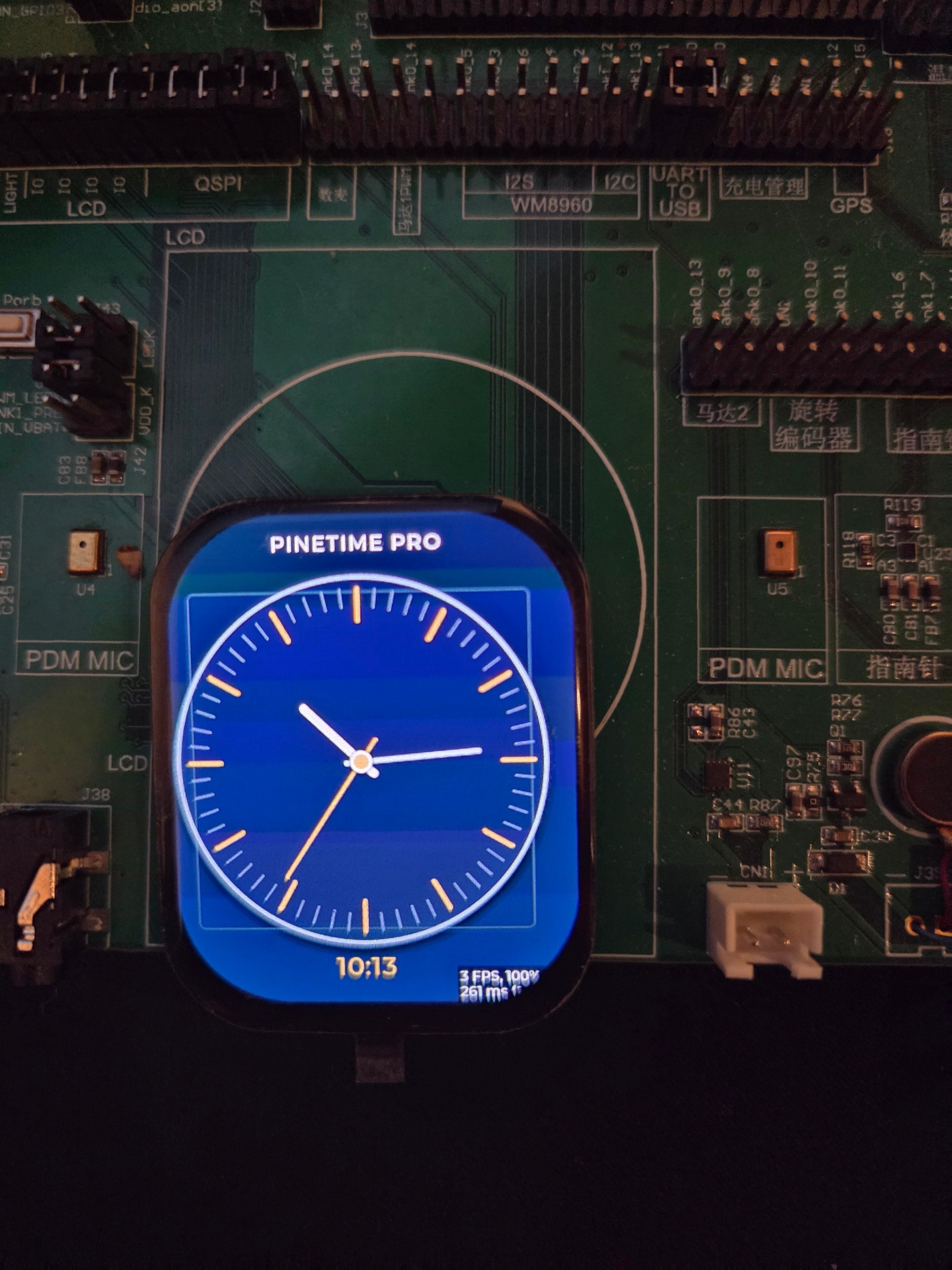

The PineTime Pro was officially announced at FOSDEM26 on the Pine64 stand. The demo was a bit modest (more on that later on), but we were delighted to showcase the first prototype of the “next generation PineTime” along with a demo running on a development board!

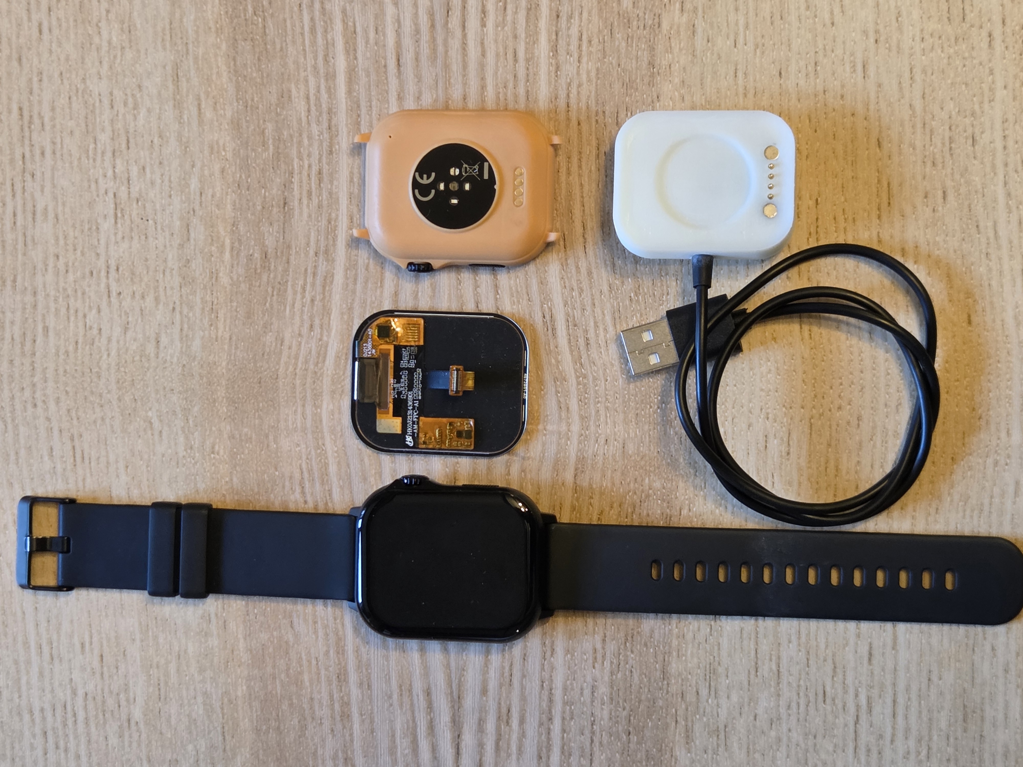

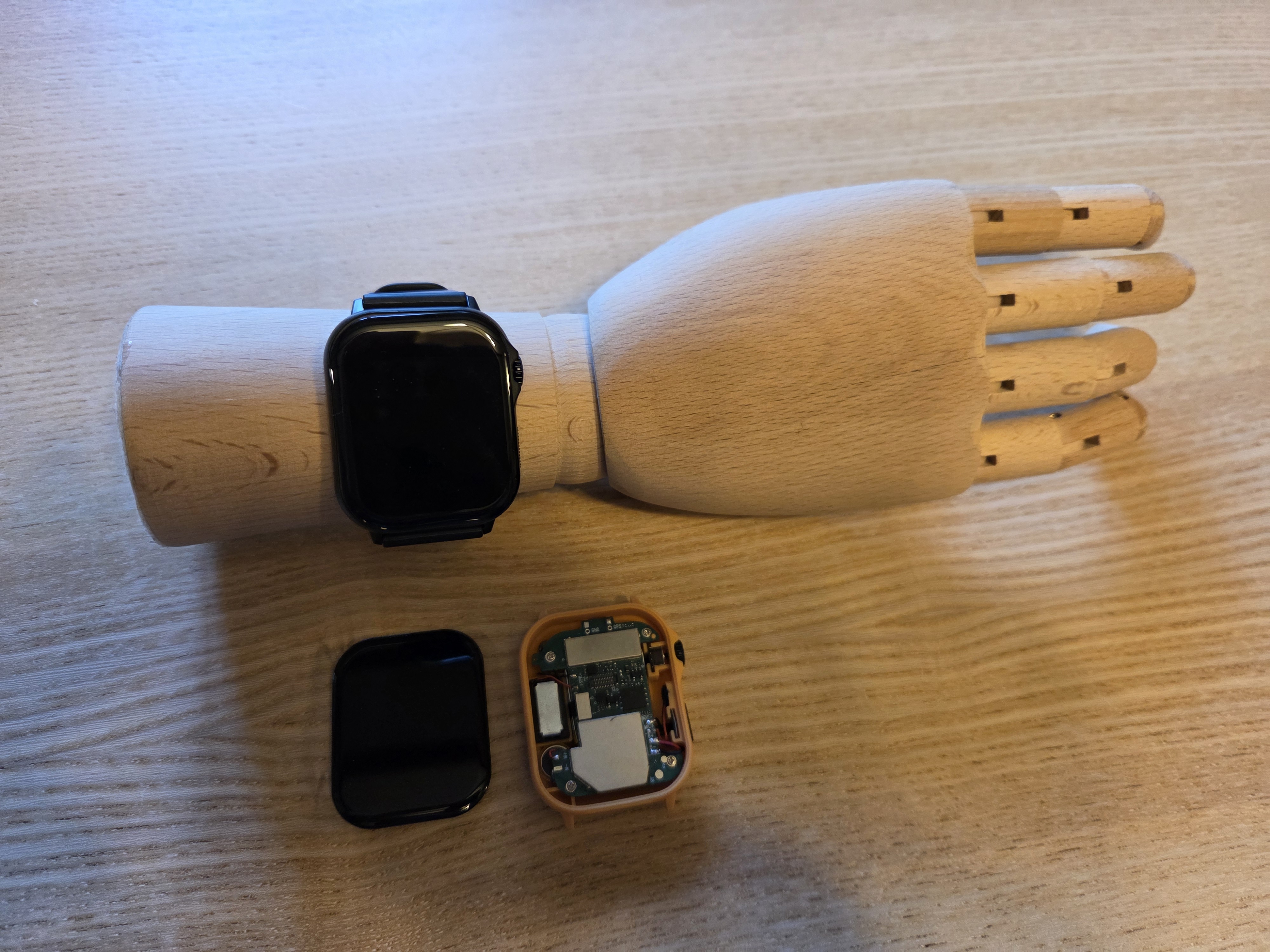

During FOSDEM 2025, we received the first two development boards based on the new Cortex-M33 platform. Throughout 2025, PineStore and community members, especially Gamiee and Ralim, continued reviewing the hardware design while JF was experimenting with the development board and the SDK.
Toward the end of 2025, the first two actual watch prototypes were sent to Gamiee and JF. Unfortunately, those boards had hardware issues that left the SWD port (the programming and debugging port) non-functional, which made software bring-up much more difficult than expected.
A second batch of prototypes arrived just before FOSDEM this year. We had hoped to show them running on the Pine64 stand, but another hardware issue got in the way: the flash memory was not working properly, so the demo had to run on the development board instead of the actual watch hardware.
